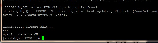

[求助] mysql升級(jí)到5.5報(bào)錯(cuò)了
本帖最后由 qq682907 于 2013-2-28 23:37 編輯
wget http://down.wdlinux.cn/in/mysql_up55.sh
sh mysql_up55.sh我是按著這個(gè)升級(jí)的 是面板安裝好后
升級(jí)的
詳細(xì)的錯(cuò)誤日志
130228 23:33:43 [Note] Server hostname (bind-address): '0.0.0.0'; port: 3306
130228 23:33:43 [Note]   - '0.0.0.0' resolves to '0.0.0.0';
130228 23:33:43 [Note] Server socket created on IP: '0.0.0.0'.
130228 23:33:43 [ERROR] Fatal error: Can't open and lock privilege tables: Table 'mysql.host' doesn't exist
130228 23:33:43 mysqld_safe mysqld from pid file /www/wdlinux/mysql-5.5.27/data/MyVPS1970.pid ended
