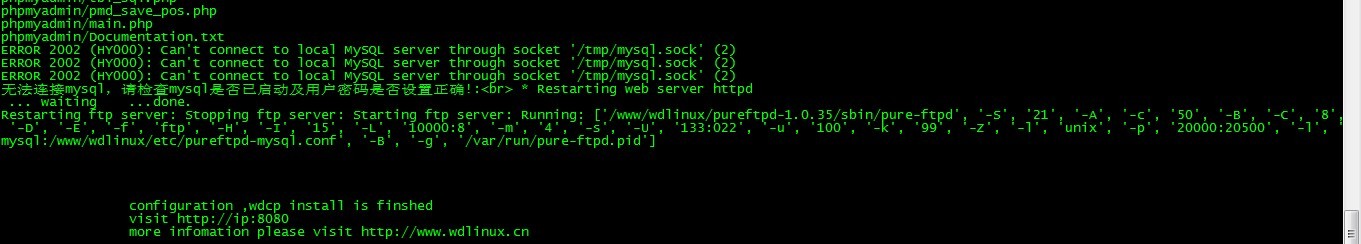

作者: 蒼狼    時間: 2012-7-2 19:44     標題: ubuntu 11.04 x86 安裝lnamp時報錯
錯誤顯示為
  1. phpmyadmin/server_binlog.php
  2. phpmyadmin/pdf_schema.php
  3. phpmyadmin/print.css
  4. phpmyadmin/tbl_sql.php
  5. phpmyadmin/pmd_save_pos.php
  6. phpmyadmin/main.php
  7. phpmyadmin/Documentation.txt
  8. ERROR 2002 (HY000): Can't connect to local MySQL server through socket '/tmp/mysql.sock' (2)
  9. ERROR 2002 (HY000): Can't connect to local MySQL server through socket '/tmp/mysql.sock' (2)
  10. ERROR 2002 (HY000): Can't connect to local MySQL server through socket '/tmp/mysql.sock' (2)
  11. 無法連接mysql,請檢查mysql是否已啟動及用戶密碼是否設(shè)置正確!:<br> * Restarting web server httpd
  12. ... waiting    ...done.
  13. Restarting ftp server: Stopping ftp server: Starting ftp server: Running: ['/www/wdlinux/pureftpd-1.0.35/sbin/pure-ftpd', '-S', '21', '-A', '-c', '50', '-B', '-C', '8', '-D', '-E', '-f', 'ftp', '-H', '-I', '15', '-L', '10000:8', '-m', '4', '-s', '-U', '133:022', '-u', '100', '-k', '99', '-Z', '-l', 'unix', '-p', '20000:20500', '-l', 'mysql:/www/wdlinux/etc/pureftpd-mysql.conf', '-B', '-g', '/var/run/pure-ftpd.pid']
  14.                 configuration ,wdcp install is finshed
  15.                 visit http://ip:8080
  16.                 more infomation please visit http://www.gps-cemuyi.cn
復(fù)制代碼

作者: admin    時間: 2012-7-2 19:55
mysql沒啟動,方便發(fā)IP,密碼來看下

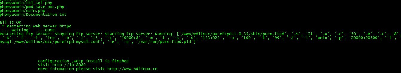

作者: 蒼狼    時間: 2012-7-3 04:23
本帖最后由 蒼狼 于 2012-7-3 04:24 編輯
重裝系統(tǒng)為12.04_x86后 Mysql 不報錯了但 prueftp 不能啟動,安裝完LNAMP后報錯如下
  1. phpmyadmin/main.php
  2. phpmyadmin/Documentation.txt
  3. all is OK
  4. * Restarting web server httpd
  5. ... waiting    ...done.
  6. Restarting ftp server: Stopping ftp server: Starting ftp server: Running: ['/www/wdlinux/pureftpd-1.0.35/sbin/pure-ftpd', '-S', '21', '-A', '-c', '50', '-B', '-C', '8', '-D', '-E', '-f', 'ftp', '-H', '-I', '15', '-L', '10000:8', '-m', '4', '-s', '-U', '133:022', '-u', '100', '-k', '99', '-Z', '-l', 'unix', '-p', '20000:20500', '-l', 'mysql:/www/wdlinux/etc/pureftpd-mysql.conf', '-B', '-g', '/var/run/pure-ftpd.pid']
  7.                 configuration ,wdcp install is finshed
  8.                 visit http://ip:8080
  9.                 more infomation please visit http://www.gps-cemuyi.cn
復(fù)制代碼

作者: itxx    時間: 2012-7-3 08:20
根據(jù)提示信息pureftp是啟動了的,用netstat 看看所有服務(wù)對應(yīng)的端口是否監(jiān)聽,如果都監(jiān)聽成功則為正常,另外mysql如果再出現(xiàn)無法啟動請重新下載lanmp一鍵包,修復(fù)了一處mysql帳號添加失敗導(dǎo)致服務(wù)無法正常啟動的問題。
