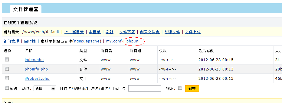

請問PHP.ini 文件在哪里?我需要修改一下.
另外大家?guī)臀铱纯矗?br /> Warning:  file_put_contents(/www/web/dongbuxincheng_com/public_html/config/install.lock.php) [function.file-put-contents]: failed to open stream: Permission denied in /www/web/dongbuxincheng_com/public_html/app/base/lib/setup/lock.php on line 47Warning:  Cannot modify header information - headers already sent by (output started at /www/web/dongbuxincheng_com/public_html/app/base/lib/setup/lock.php:47) in /www/web/dongbuxincheng_com/public_html/app/setup/controller/default.php on line 92Warning:  file_put_contents(/www/web/dongbuxincheng_com/public_html/config/config.php) [function.file-put-contents]: failed to open stream: Permission denied in /www/web/dongbuxincheng_com/public_html/app/base/lib/setup/config.php on line 35Error: Config文件寫入錯誤                file_put_contents函數(shù)為何會出錯?謝謝大家了!
作者: marquis    時間: 2012-7-27 09:28
回復(fù) 1# 半夜洗衣服
圖片附件: QQ截圖20120727092245.png (2012-7-27 09:28, 16.36 KB) / 下載次數(shù) 6735
