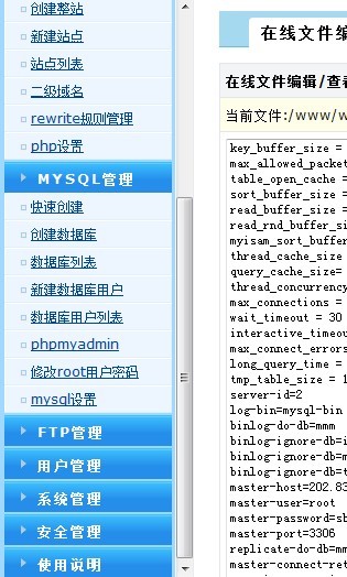

完成數(shù)據(jù)同步,直接在線修改my.cnf。重啟,,記得先在防火墻開(kāi)對(duì)應(yīng)3306端口,,不要告訴我你不知道,,還有個(gè)就是,數(shù)據(jù)雙向同步,需做ID的處理,否則將產(chǎn)生ID沖突導(dǎo)致錯(cuò)誤,這個(gè)在這里我就保留一手了,,請(qǐng)見(jiàn)諒。。。。。網(wǎng)上似乎也能找到資料,不過(guò)很少很少,,
LINUX---A
server-id=1
log-bin=mysql-bin
binlog-do-db=需數(shù)據(jù)庫(kù)
binlog-ignore-db=information_schema
binlog-ignore-db=mysql
binlog-ignore-db=test
master-host=被同步IP
master-user=被同步帳號(hào)
master-password=被同步密碼
master-port=3306
replicate-do-db=需數(shù)據(jù)庫(kù)
master-connect-retry=60
LINUX---B
server-id=2
log-bin=mysql-bin
master-host=被同步IP
master-port=3306

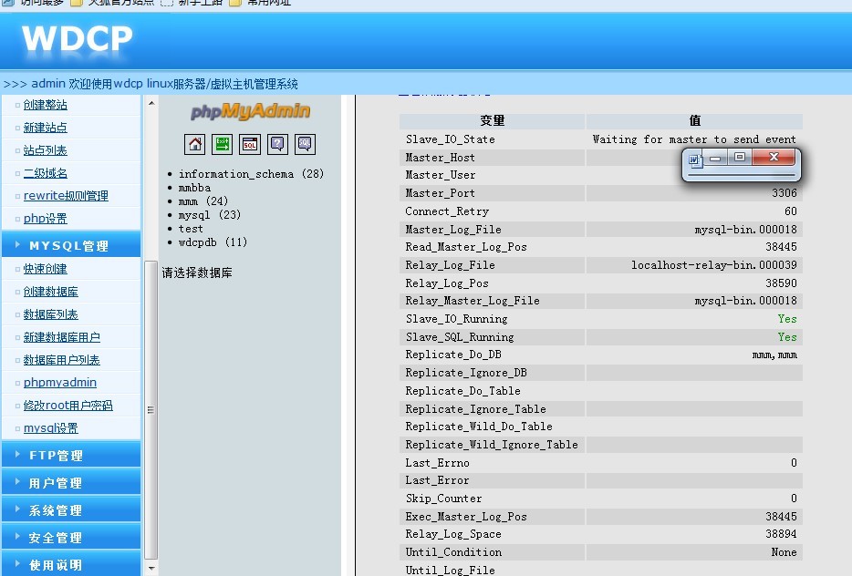

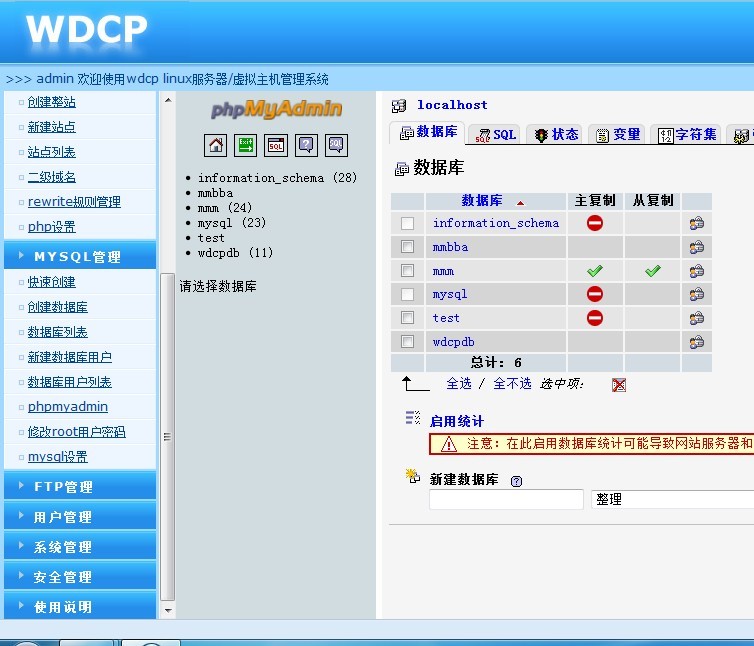

完成效果,
