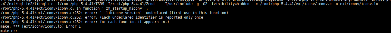

PHP5.3  升級 最新PHP5.4.41 的問題
/root/php-5.4.41/ext/iconv/iconv.c: In function ‘zm_startup_miconv’:
/root/php-5.4.41/ext/iconv/iconv.c:252: error: ‘_libiconv_version’ undeclared (first use in this function)
/root/php-5.4.41/ext/iconv/iconv.c:252: error: (Each undeclared identifier is reported only once
/root/php-5.4.41/ext/iconv/iconv.c:252: error: for each function it appears in.)
make: *** [ext/iconv/iconv.lo] Error 1
make err
圖片附件: IUUX9ASG7YFNKB[2HEX4YP2.png (2015-6-2 23:36, 11.55 KB) / 下載次數(shù) 7561
http://www.gps-cemuyi.cn/bbs/attachment.php?aid=5388&k=8f924bc55d317c99ef995fdb168cf3f5&t=1747203172&sid=gJsIJB
作者: web58@qq.com    時間: 2015-6-7 15:53
我也出現(xiàn)和你一樣的情況,摸索了幾天 終于搞定了
如果你的iconv安裝正常的話,你只要把php_up54.sh 里面的--with-iconv=/usr 改成--with-iconv-dir=/usr  有兩處。
