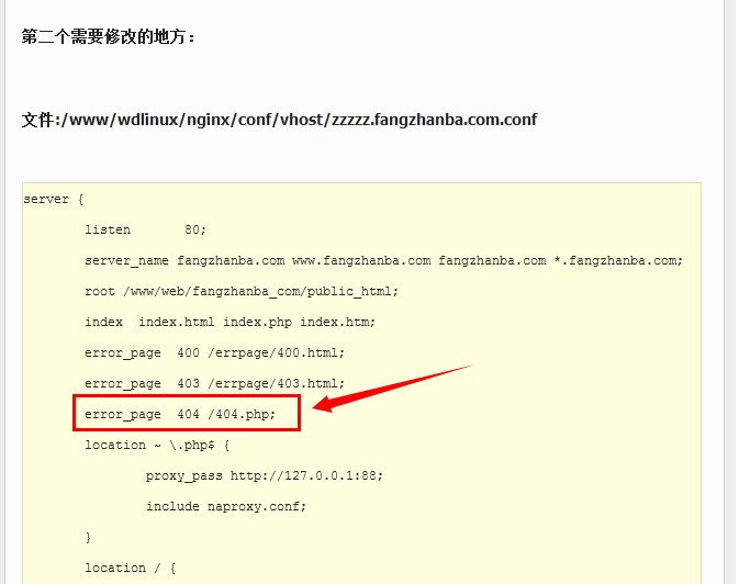

wdos一鍵安裝版,用的nginx,是這樣改嗎:
/www/wdlinux/nginx-1.0.15/conf/vhost/site_name.conf
server {
        listen       80;
        server_name site_name;
        root /www/web/site_name/public_html;
        index index.php index.htm;
        error_page  400 /errpage/400.html;
        error_page  403 /errpage/403.html;
        error_page  404 /errpage/404.php;  #這里就可以了?
        error_page  405 /errpage/405.html;
        location ~ \.php$ {
                fastcgi_pass   127.0.0.1:9000;
                fastcgi_index  index.php;
                include fcgi.conf;

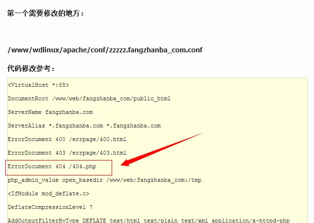

作者: hanfei    時(shí)間: 2014-7-11 21:52
圖片附件: 001.jpg (2014-7-11 21:51, 51.57 KB) / 下載次數(shù) 13686
http://www.gps-cemuyi.cn/bbs/attachment.php?aid=4672&k=3a408ae2a5eb7dee02896ce4064b2643&t=1746547907&sid=XlL7ZA
圖片附件: 002.jpg (2014-7-11 21:52, 53.33 KB) / 下載次數(shù) 13676
http://www.gps-cemuyi.cn/bbs/attachment.php?aid=4673&k=281b39acd180722aadf4cbac23d42577&t=1746547907&sid=XlL7ZA
作者: hanfei    時(shí)間: 2014-7-11 21:53
回復(fù) 1# hjc91
圖片附件: 001.jpg (2014-7-11 21:52, 51.57 KB) / 下載次數(shù) 13703
http://www.gps-cemuyi.cn/bbs/attachment.php?aid=4674&k=a6930e2484623939ed315da4f6458d42&t=1746547907&sid=XlL7ZA
圖片附件: 002.jpg (2014-7-11 21:52, 53.33 KB) / 下載次數(shù) 13704
http://www.gps-cemuyi.cn/bbs/attachment.php?aid=4675&k=59752ec8a31a8da296ce1fa75cf57863&t=1746547907&sid=XlL7ZA
