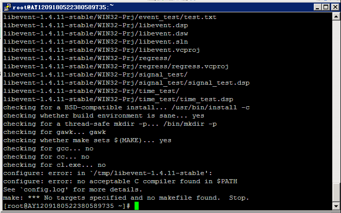

如題 ,看下圖
libevent-1.4.11-stable/WIN32-Prj/event_test/test.txt
libevent-1.4.11-stable/WIN32-Prj/libevent.dsp
libevent-1.4.11-stable/WIN32-Prj/libevent.dsw
libevent-1.4.11-stable/WIN32-Prj/libevent.sln
libevent-1.4.11-stable/WIN32-Prj/libevent.vcproj
libevent-1.4.11-stable/WIN32-Prj/regress/
libevent-1.4.11-stable/WIN32-Prj/regress/regress.vcproj
libevent-1.4.11-stable/WIN32-Prj/signal_test/
libevent-1.4.11-stable/WIN32-Prj/signal_test/signal_test.dsp
libevent-1.4.11-stable/WIN32-Prj/time_test/
libevent-1.4.11-stable/WIN32-Prj/time_test/time_test.dsp
checking for a BSD-compatible install... /usr/bin/install -c
checking whether build environment is sane... yes
checking for a thread-safe mkdir -p... /bin/mkdir -p
checking for gawk... gawk
checking whether make sets $(MAKE)... yes
checking for gcc... no
checking for cc... no
checking for cl.exe... no
configure: error: in `/tmp/libevent-1.4.11-stable':
configure: error: no acceptable C compiler found in $PATH
See `config.log' for more details.
make: *** No targets specified and no makefile found.  Stop.

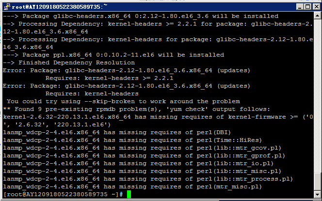

按照老大說的是GCC“yum install -y gcc gcc-c++ make autoconf libtool-ltdl-devel ” 安裝但是又出現(xiàn)下面錯(cuò)誤了。暈

加個(gè)--skip-broken參數(shù)試試
