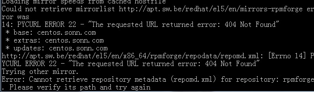

wget http://dl.wdlinux.cn:5180/lanmp_laster.tar.gzwget http://down.wdlinux.cn/in/lanmp_wdcp_ins.sh

sh install.sh每個都安裝了一邊都不行!后臺8080可以訪問,80端口打不開 傲游截圖20160901234713.jpg 安裝的時候提示404這個文件不存在的!

我用阿里的可以安裝!國外的就不行了,我每個版本都試過就是不行,8080后臺可以打開,前天80端口就是訪問錯誤
作者: qq2517328    時間: 2016-9-20 21:23
Could not retrieve mirrorlist http://apt.sw.be/redhat/el6/en/mirrors-rpmforge error was
14: PYCURL ERROR 22 - "The requested URL returned error: 404 Not Found"

http://apt.sw.be/redhat/el6/en/x86_64/rpmforge/repodata/repomd.xml: [Errno 14] PYCURL ERROR 22 - "The requested URL returned error: 404 Not Found"
Trying other mirror.
Error: Cannot retrieve repository metadata (repomd.xml) for repository: rpmforge. Please verify its path and try again

作者: qq2517328    時間: 2016-9-20 21:24
提示文件找不到404
