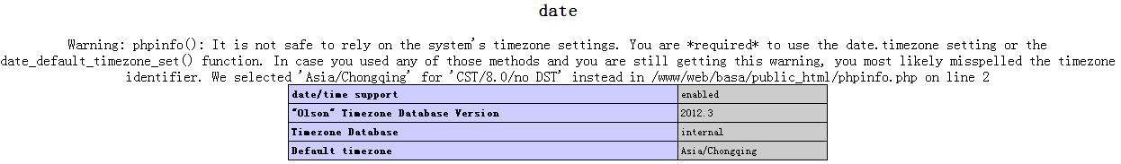

查看phpinfo的時候出現(xiàn)如下提示
  1. Warning: phpinfo(): It is not safe to rely on the system's timezone settings. You are *required* to use the date.timezone setting or the date_default_timezone_set() function. In case you used any of those methods and you are still getting this warning, you most likely misspelled the timezone identifier. We selected 'Asia/Chongqing' for 'CST/8.0/no DST' instead in /www/web/basa/public_html/phpinfo.php on line 2

圖片附件: 剪貼板3.jpg (2013-6-22 14:41, 46.3 KB) / 下載次數(shù) 7138

應該是需要在php.ini中指定個默認時區(qū)
作者: 問題用戶    時間: 2013-6-23 11:28
謝謝版主,修改后確實好了
