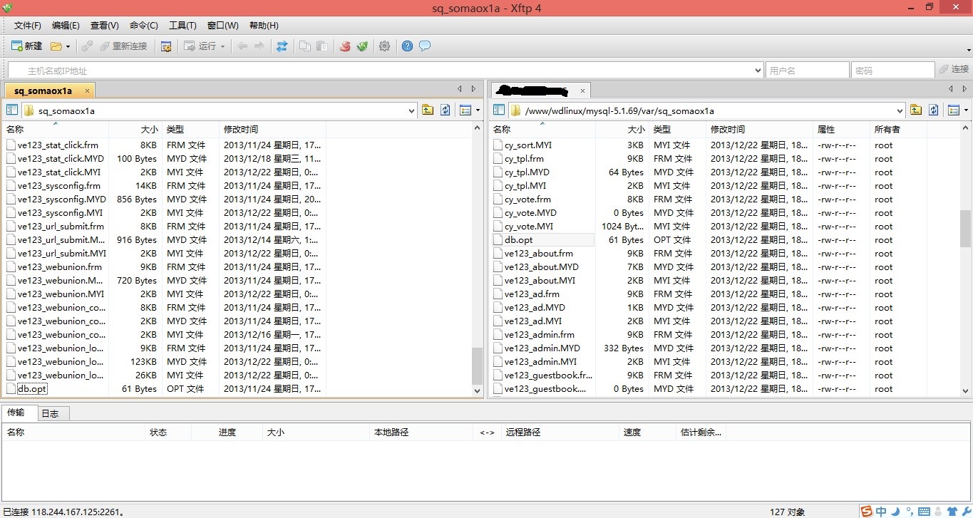

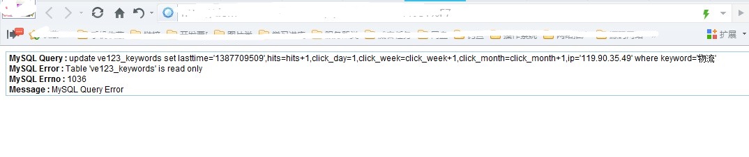

TãҵIJϵy(tng) centos5.6汾   ʹwdһIr(sh)  ڂ(g)ԭ wd܉ҰѾW(wng)վ͔(sh)(j)춼°bһwdҲõ nginx+apacheģʽҰтĔ(sh)(j)ς֮ǰһģһӵĔ(sh)(j)Ŀ£עςֻǔ(sh)(j)ıĿLW(wng)վ  (sh)(j)e(cu)֪զ£ǔ(sh)(j)ę(qun)ކ}߀ʲôՈ(qng)ToQD
DƬ: 1.jpg (2013-12-22 19:07, 345.45 KB) / dΔ(sh) 9559

DƬ: 2.jpg (2013-12-22 19:08, 50.59 KB) / dΔ(sh) 9126

: admin    r(sh)g: 2013-12-23 09:42
ԓĿˆ(zh)
chown mysql.mysql *
