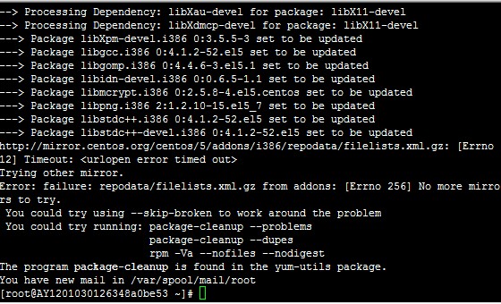

[求助] 阿里云主機(jī),centos 5.4 多次安裝最新的2.2均不成功
全新安裝的時(shí)候,install Error :mysql configure errr
然后在下面鍵入
  1. yum install -y gcc gcc-c++ make autoconf libtool-ltdl-devel gd-devel freetype-devel libxml2-devel libjpeg-devel libpng-devel openssl-devel curl-devel patch libmcrypt-devel libmhash-devel ncurses-devel sudo bzip2
復(fù)制代碼
然后出現(xiàn)
  1. ---> Package libstdc++-devel.i386 0:4.1.2-52.el5 set to be updated
  2. http://mirror.centos.org/centos/5/addons/i386/repodata/filelists.xml.gz: [Errno 12] Timeout: <urlopen error timed out>
  3. Trying other mirror.
  4. Error: failure: repodata/filelists.xml.gz from addons: [Errno 256] No more mirrors to try.
  5. You could try using --skip-broken to work around the problem
  6. You could try running: package-cleanup --problems
  7. package-cleanup --dupes
  8. rpm -Va --nofiles --nodigest
  9. The program package-cleanup is found in the yum-utils package.
  10. You have new mail in /var/spool/mail/root
復(fù)制代碼

本帖最后由 阿飛劉 于 2012-3-11 16:17 編輯
  1. ---> Package libXpm-devel.i386 0:3.5.5-3 set to be updated
  2. ---> Package libgcc.i386 0:4.1.2-52.el5 set to be updated
  3. ---> Package libgomp.i386 0:4.4.6-3.el5.1 set to be updated
  4. ---> Package libidn-devel.i386 0:0.6.5-1.1 set to be updated
  5. ---> Package libmcrypt.i386 0:2.5.8-4.el5.centos set to be updated
  6. ---> Package libpng.i386 2:1.2.10-15.el5_7 set to be updated
  7. ---> Package libstdc++.i386 0:4.1.2-52.el5 set to be updated
  8. ---> Package libstdc++-devel.i386 0:4.1.2-52.el5 set to be updated
  9. addons/filelists                                         |  180 B     00:00
  10. http://mirror.centos.org/centos/5/addons/i386/repodata/filelists.xml.gz: [Errno -1] Metadata file does not match checksum
  11. Trying other mirror.
  12. Error: failure: repodata/filelists.xml.gz from addons: [Errno 256] No more mirrors to try.
  13. You could try using --skip-broken to work around the problem
  14. You could try running: package-cleanup --problems
  15.                         package-cleanup --dupes
  16.                         rpm -Va --nofiles --nodigest
  17. The program package-cleanup is found in the yum-utils package.

  144. checking whether build environment is sane... yes
  145. checking for a thread-safe mkdir -p... /bin/mkdir -p
  146. checking for gawk... gawk
  147. checking whether make sets $(MAKE)... yes
  148. checking how to create a ustar tar archive... gnutar
  149. checking for style of include used by make... GNU
  150. checking for gcc... no
  151. checking for cc... no
  152. checking for cl.exe... no
  153. configure: error: in `/root/lanmp/mysql-5.1.61':
  154. configure: error: no acceptable C compiler found in $PATH
  155. See `config.log' for more details.
  156. ----Install Error: mysql configure err -----------
復(fù)制代碼
TOP
DNS錯(cuò)誤,域名解釋不了
所以
這個(gè)也沒更新成功
TOP
那怎么解決
TOP
換一個(gè)DNS
TOP
換虛擬主機(jī)的dns?
TOP
我有一臺(tái)5.4的也是這個(gè)問題。不理解咋 回事
TOP
DNS不行,所以域名解析不了,所以yum更新不成功,所以沒有相關(guān)的依懶包和庫(kù),所以安裝不成功
可以換一個(gè)DNS試試,可以看/etc/resolv.conf這個(gè)文件
TOP
云主機(jī)可以重置下
TOP
