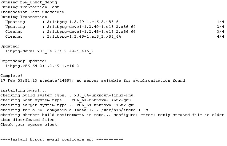

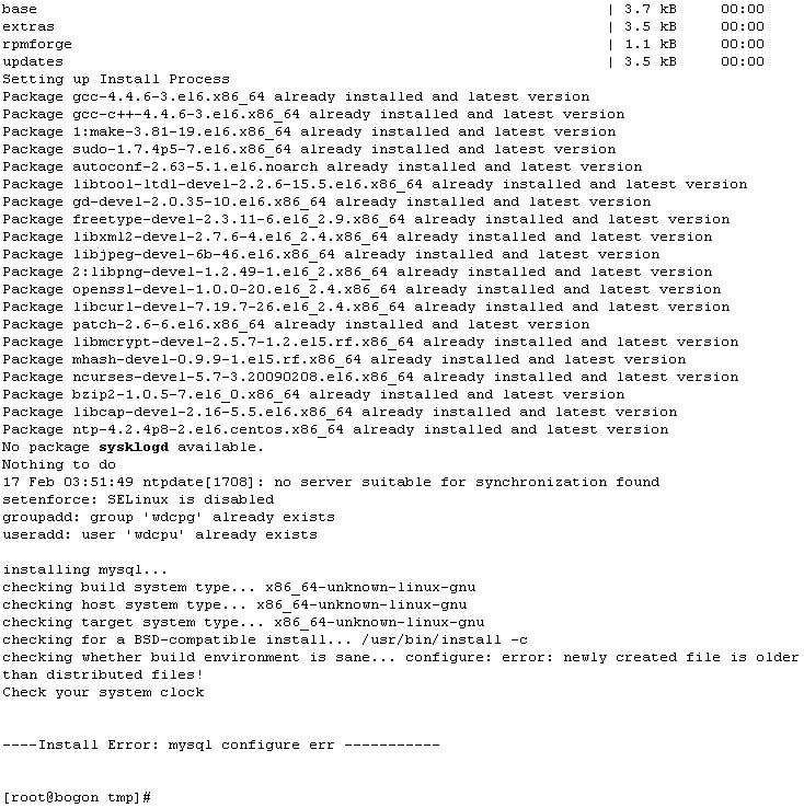

ϴ(wn)ʲôϵy(tng)͛]˸ԵÑҕQˡ
ҵCentOS 6.0ǏFW(wng)վµisoļ wdlinux_base_64_6.iso
Ո(qng)ϴ(li)Q(wn)}ѽx
؈D
ba
[root@bogon tmp]# sh in.sh
Select Install
        1 apache + php + mysql + zend + eAccelerator + pureftpd + phpmyadmin
        2 nginx + php + mysql + zend + eAccelerator + pureftpd + phpmyadmin
        3 nginx + apache + php + mysql + zend + eAccelerator + pureftpd + phpmyadmin
        4 don't install is now
Please Input 1,2,3,4: 1
PING www.gps-cemuyi.cn (122.49.11.85) 56(84) bytes of data.
64 bytes from 122.49.11.85: icmp_seq=1 ttl=53 time=323 ms
--- www.gps-cemuyi.cn ping statistics ---
1 packets transmitted, 1 received, 0% packet loss, time 799ms
rtt min/avg/max/mdev = 323.546/323.546/323.546/0.000 ms
CentOS Linux release 6.0 (Final)
error: lanmp/RPM-GPG-KEY.dag.txt: key 1 import failed.
Preparing...                ########################################### [100%]
        package rpmforge-release-0.5.2-2.el5.rf.x86_64 is already installed
base                                                                 | 3.7 kB     00:00
extras                                                               | 3.5 kB     00:00
rpmforge                                                             | 1.1 kB     00:00
rpmforge/primary                                                     | 4.0 MB     03:28
rpmforge                                                                        11165/11165
updates                                                              | 3.5 kB     00:00
updates/primary_db                                                   | 2.9 MB     00:49
Setting up Install Process
Package gcc-4.4.6-3.el6.x86_64 already installed and latest version
Package gcc-c++-4.4.6-3.el6.x86_64 already installed and latest version
Package 1:make-3.81-19.el6.x86_64 already installed and latest version
Package sudo-1.7.4p5-7.el6.x86_64 already installed and latest version
Package autoconf-2.63-5.1.el6.noarch already installed and latest version
Package libtool-ltdl-devel-2.2.6-15.5.el6.x86_64 already installed and latest version
Package gd-devel-2.0.35-10.el6.x86_64 already installed and latest version
Package freetype-devel-2.3.11-6.el6_2.9.x86_64 already installed and latest version
Package libxml2-devel-2.7.6-4.el6_2.4.x86_64 already installed and latest version
Package libjpeg-devel-6b-46.el6.x86_64 already installed and latest version
Package openssl-devel-1.0.0-20.el6_2.4.x86_64 already installed and latest version
Package libcurl-devel-7.19.7-26.el6_2.4.x86_64 already installed and latest version
Package patch-2.6-6.el6.x86_64 already installed and latest version
Package libmcrypt-devel-2.5.7-1.2.el5.rf.x86_64 already installed and latest version
Package mhash-devel-0.9.9-1.el5.rf.x86_64 already installed and latest version
Package ncurses-devel-5.7-3.20090208.el6.x86_64 already installed and latest version
Package bzip2-1.0.5-7.el6_0.x86_64 already installed and latest version
Package libcap-devel-2.16-5.5.el6.x86_64 already installed and latest version
Package ntp-4.2.4p8-2.el6.centos.x86_64 already installed and latest version
No package sysklogd available.
Resolving Dependencies
--> Running transaction check
---> Package libpng-devel.x86_64 2:1.2.49-1.el6_2 set to be updated
--> Processing Dependency: libpng = 2:1.2.49-1.el6_2 for package: 2:libpng-devel-1.2.49-1.el6_2.x86_64
---> Package libpng.x86_64 2:1.2.49-1.el6_2 set to be updated
--> Finished Dependency Resolution
Dependencies Resolved
Package                Arch             Version                    Repository         Size
Updating:
libpng-devel           x86_64           2:1.2.49-1.el6_2           updates           112 k
Updating for dependencies:
libpng                 x86_64           2:1.2.49-1.el6_2           updates           182 k
Transaction Summary
Install       0 Package(s)
Upgrade       2 Package(s)
Total download size: 294 k
Downloading Packages:
(1/2): libpng-1.2.49-1.el6_2.x86_64.rpm                              | 182 kB     00:05
(2/2): libpng-devel-1.2.49-1.el6_2.x86_64.rpm                        | 112 kB     00:01
Total                                                        43 kB/s | 294 kB     00:06
Running rpm_check_debug
Running Transaction Test
Transaction Test Succeeded
Running Transaction
  Updating       : 2:libpng-1.2.49-1.el6_2.x86_64                                       1/4
  Updating       : 2:libpng-devel-1.2.49-1.el6_2.x86_64                                 2/4
  Cleanup        : 2:libpng-devel-1.2.48-1.el6_2.x86_64                                 3/4
  Cleanup        : 2:libpng-1.2.48-1.el6_2.x86_64                                       4/4
Updated:
Dependency Updated:
Complete!
17 Feb 03:51:13 ntpdate[1489]: no server suitable for synchronization found
installing mysql...
checking build system type... x86_64-unknown-linux-gnu
checking host system type... x86_64-unknown-linux-gnu
checking target system type... x86_64-unknown-linux-gnu
checking for a BSD-compatible install... /usr/bin/install -c
checking whether build environment is sane... configure: error: newly created file is older than distributed files!
Check your system clock
----Install Error: mysql configure err -----------
64 bytes from 122.49.11.85: icmp_seq=1 ttl=53 time=142 ms
1 packets transmitted, 1 received, 0% packet loss, time 374ms
rtt min/avg/max/mdev = 142.939/142.939/142.939/0.000 ms
base                                                                 | 3.7 kB     00:00
Package 2:libpng-devel-1.2.49-1.el6_2.x86_64 already installed and latest version
Nothing to do
17 Feb 03:51:49 ntpdate[1708]: no server suitable for synchronization found
setenforce: SELinux is disabled
groupadd: group 'wdcpg' already exists
useradd: user 'wdcpu' already exists
installing mysql...
[root@bogon tmp]#

: itxsy    r(sh)g: 2012-4-26 19:57
a(b)†(wn)}µİbµ2.3ǿļ2.2ļ
http://www.gps-cemuyi.cn/bbs/thread-1788-1-1.html
⿴(g)Ҳ@(g)(wn)}ϴ؏(f)f(shu)]gҿg40GӲPͰb@(g)|؜y(c)ԇC(j)
[root@bogon ~]# df -h
Filesystem            Size  Used Avail Use% Mounted on
/dev/mapper/vg_bogon-lv_root
                       33G  1.4G   30G   5% /
tmpfs                 877M     0  877M   0% /dev/shm
/dev/sda1             485M   30M  430M   7% /boot
: admin    r(sh)g: 2012-4-27 00:49
ϵy(tng)r(sh)g(wn)}޸ϵy(tng)r(sh)g鮔(dng)ǰr(sh)g
: happyboy    r(sh)g: 2013-3-25 10:38
Check your system clockϵy(tng)r(sh)g(wn)}
gӭR WDlinuxٷՓ (http://www.gps-cemuyi.cn/bbs/) Powered by Discuz! 7.2
