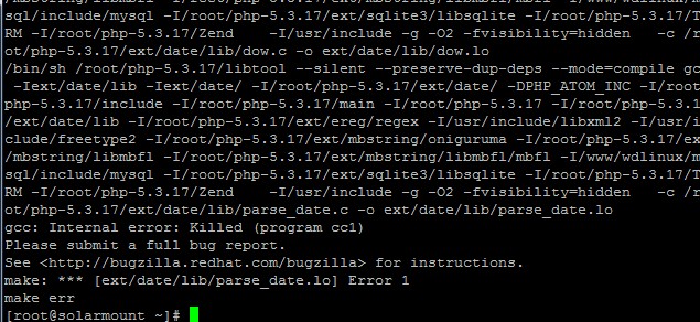

升級php報(bào)錯(cuò)gcc: Internal error: Killed (program cc1)
Please submit a full bug report.
See <http://bugzilla.redhat.com/bugzilla> for instructions.
make: *** [ext/date/lib/parse_date.lo] Error 1
make err怎么處理啊

wdcp_v2.5.10  想升級 php5.3 ,卻出現(xiàn)了問題
make err
